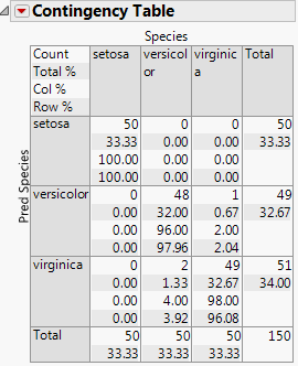

From the updated Iris.jmp data table (that contains the new columns) select Analyze > Fit Y by X.
2.
Select Species and click Y, Response.
3.
Select Pred Species and click X, Factor.
4.
Figure 8.13 Contingency Table of Predicted and Actual Species
