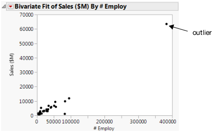

5.
Figure 6.149 Initial Scatterplot
6.
Turn on Automatic Recalc by selecting Redo > Automatic Recalc from the red triangle menu.

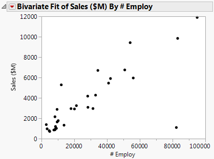

8.
Select Rows > Exclude/Unexclude. The point is excluded from the analysis and the scatterplot is automatically updated.

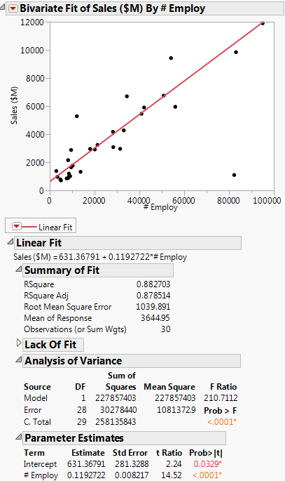

9.
Fit a regression line by selecting Fit Line from the red triangle menu. Figure 6.151 shows the regression line and analysis results added to the report window.
Figure 6.151 Regression Line and Analysis Results

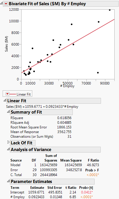

11.
Select Rows > Exclude/Unexclude. The regression line and analysis results are automatically updated, reflecting the exclusion of the point.
