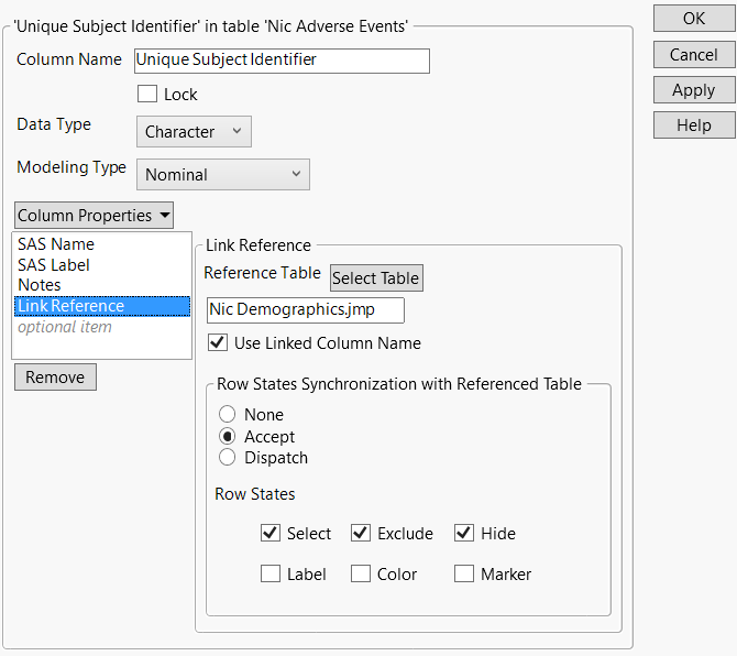

3.
In Nic Labs.jmp, select the Unique Subject Identifier column and select Cols > Column Info.
4.
Select the Link Reference column property.
Notice that Accept is selected. This means that when rows in the referenced data table (Nic Demographics.jmp) contain a row state, the row state automatically appears in the current data table.
Also notice that the Select, Exclude, and Hide row states are selected. When these row states are selected in Nic Demographics.jmp, the row states will appear in Nic Lib.jmp and Nic Adverse Events.jmp.
