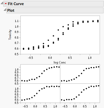

The Fit Curve Report appears as shown in Figure 11.2. The Plot report contains an overlaid plot of the fitted model of each formulation.
Figure 11.2 Initial Fit Curve Report

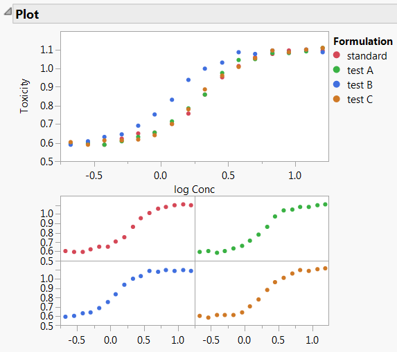

7.
To see a legend identifying each drug formulation, right-click one of the graphs and select Row Legend. Select Formulation for the column and click OK. The plot shown in Figure 11.3 appears.
Figure 11.3 Fit Curve Report with Plot Legend
The curves appear S-shaped, so a sigmoid curve would be an appropriate fit. Table 11.1 shows formulas and graphical depictions of the different types of models that the Fit Curve platform offers.

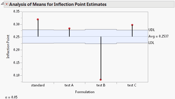

The Logistic 4P report appears (Figure 11.4). There is also a separate plot for each drug formulation. The plot of the fitted curves suggests that formulation B might be different, because the test B curve starts to rise sooner than the others. Inflection point parameters cause this rise.
9.
Select Compare Parameter Estimates from the Logistic 4P red triangle menu.
Figure 11.5 Parameter Comparison Report
