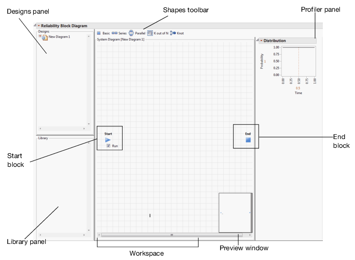

Select Analyze > Reliability and Survival > Reliability Block Diagram.
Figure 10.2 New Reliability Block Diagram
