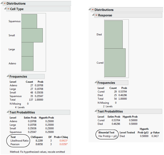

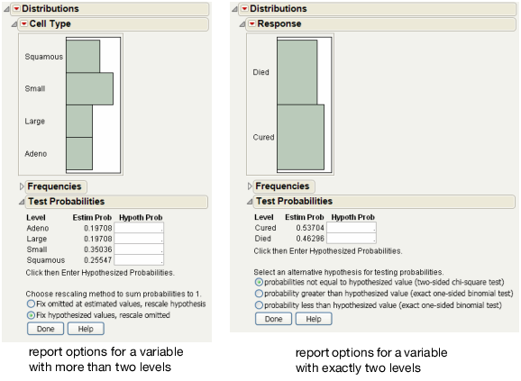

Figure 2.15 Examples of Test Probabilities Options
1.
Refer to Figure 2.15 at left. Type 0.25 in all four Hypoth Prob fields.
2.
Click the Fix hypothesized values, rescale omitted button.
3.
Click Done.
1.
Refer to Figure 2.15 at right. Type 0.5 in both Hypoth Prob fields.
2.
Click the probability less than hypothesized value button.
3.
Click Done.
Figure 2.16 Examples of Test Probabilities Reports
