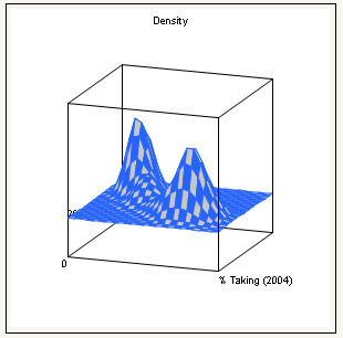

Is a three-dimensional plot of the density over a grid of the two analysis variables. See Figure 4.40.
Figure 4.40 Example of a Mesh Plot
