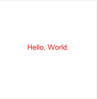

scene = Scene Box( 400, 400 ); // make a scene box.
New Window( "Example 1", scene ); // put the scene in a window.
scene << Perspective( 45, 3, 7 ); // define the camera
scene << Translate( 0.0, 0.0, -4.5 ); // move to (0,0,-4.5) to draw
scene << Color( 1, 0, 0 ); // set the RGB color of the text
scene << Text( center, baseline, 0.2, "Hello, World." ); // add text
scene << Update; // update the scene
The first two lines create a scene and place it in a window. The Perspective command defines the viewing angle and field depth. By sending it as a message to the scene, it is immediately added to the scene’s display list. Since the “Hello World” text is to be drawn at the origin (0, 0, 0), the Translate command is added to the display list to move the camera back a bit so that the origin is in the field of vision. The color is set to red with the Color command, the text is drawn, and the Update command causes the scene to be rendered (in other words, causes the display list that contains the commands to be drawn.)
Figure 12.3 Hello World

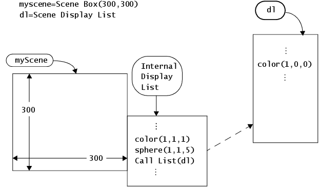

greeting=Scene Display List();
Display commands can then be sent as messages to greeting. An equivalent “Hello World” example using a display list follows.
greeting = Scene Display List();
greeting << Color( 1, 0, 0 ); // set the RGB color of the text
greeting << Text( center, baseline, 0.2, "Hello, World." ); // add text
// draw the window and send it the stored display list
scene << Call List( greeting ); // send the display list to the scene
Note which commands were separated into the display list, and which were applied to the scene directly. Those that manipulate the camera (Translate and Rotate) are applied to the scene. Those that define the object (Color and Text) were relegated to the display list. This is done so that the display list can be called many times to replicate the object at different positions.
