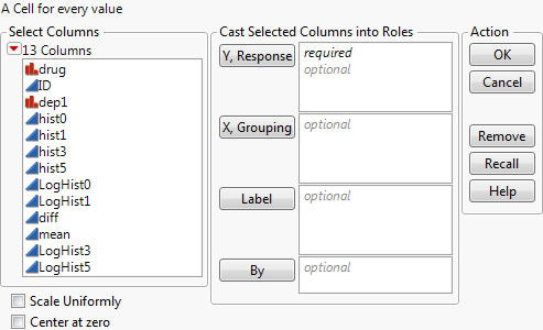

Launch the Cell Plot platform by selecting
Graph > Cell Plot
Figure 9.3
The Cell Plot Launch Window
Y, Response
Variables appear on the horizontal axis of the cell plot. Each cell represents a value.
X, Grouping
Produces a separate cell plot for each level of the variable.
Label
Labels each row by the specified variable. See
Additional Example of the Cell Plot Platform
By
Identifies a column that creates a report consisting of separate analyses for each level of the variable.
Scale Uniformly
Represents all variables on the same scale. Without this option, each variable is on a different scale.
Center at zero
Centers the cell plot at zero.
After you click
OK
, the Cell Plot window appears. See
The Cell Plot
