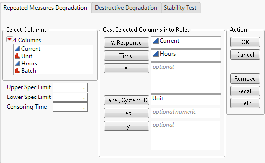

Launch the Degradation platform by selecting Analyze > Reliability and Survival > Degradation. Figure 6.3 shows the Degradation launch window using the GaAs Laser.jmp data table (located in the Reliability folder).
Figure 6.3 The Degradation Launch Window
