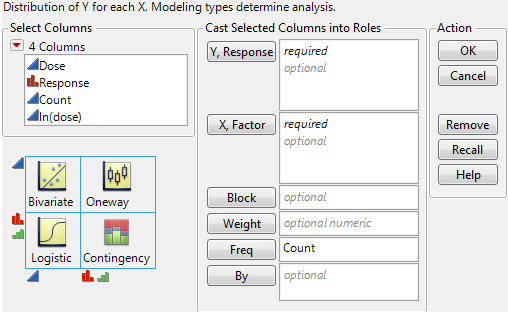

Analyze > Fit Y by X
Figure 3.23
The Fit Y by X Launch Window
Bivariate, Oneway, Logistic, Contingency
This grid shows which analysis results from the different combinations of data types. Once you have assigned your columns, the applicable platform appears as a label above the grid.
