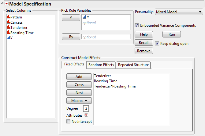

The fixed effects for analysis of the Split Plot.jmp sample data table appear in Figure 7.7. Note that it is possible to have no fixed effects in the model. For an example, see Spatial Example: Uniformity Trial.
Figure 7.7 Fit Model Launch Window Showing Completed Fixed Effects

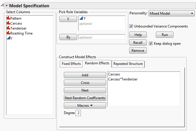

Figure 7.8 shows the random effects specification for the Split Plot.jmp sample data where Carcass is a random block. Split Plot Example describes the example in detail.
Figure 7.8 Fit Model Launch Window Showing Completed Random Effects Tab

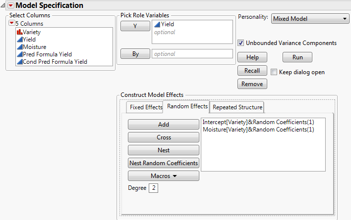

Random coefficients are modeled using an unstructured covariance structure. Figure 7.9 shows the random coefficients specification for the Wheat.jmp sample data. (See also Example Using Mixed Model.)
Figure 7.9 Completed Fit Model Launch Window Showing Random Coefficients

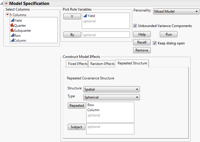

Figure 7.10 Completed Fit Model Launch Window Showing Repeated Structure Tab
