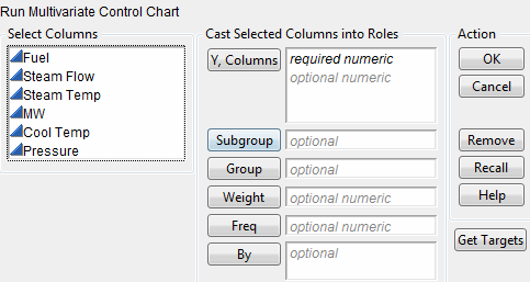

Launch the Multivariate Control Chart platform by selecting
Analyze > Quality And Process > Control Chart > Multivariate Control Chart
Figure 6.5
The Multivariate Control Chart Launch Window
Y, Columns
Specify the columns to be analyzed.
Subgroup
Enter a column with sub-grouped data. Hierarchically, this group is nested within
Group
Group
Enter a column that specifies group membership at the highest hierarchical level.
Weight
Identifies the data table column whose variables assign weight (such as importance or influence) to the data.
Freq
Identifies the data table column whose values assign a frequency to each row. Can be useful when your data table contains summarized data.
By
Identifies a column that creates a report consisting of separate analyses for each level of the variable.
Get Targets
Click to select a JMP table that contains historical targets for the process.
