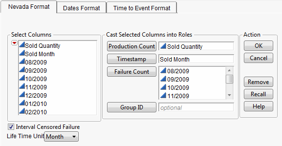

Launch the Reliability Forecast platform by selecting Analyze > Reliability and Survival > Reliability Forecast.
Figure 8.7 The Reliability Forecast Launch Window

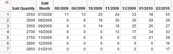

Figure 8.8 Example of the Nevada Format

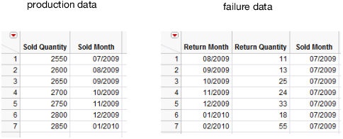

Figure 8.9 shows the Small Production part1.jmp and Small Production part2.jmp sample data tables.
Figure 8.9 Example of the Dates Format
