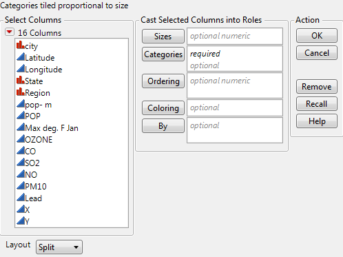

Launch the Treemap platform by selecting
Graph > Legacy > Treemap
Figure 10.6
The Treemap Launch Window
Sizes
Determines the size of the rectangles based on the values of the specified variable. See
Sizes
Categories
Specifies the category that comprises the treemap. See
Categories
Ordering
Changes the ordering from alphabetical (where values progress from the top left to the lower right) to order by the specified variable. You can specify more than one ordering variable. See
Ordering
Coloring
Colors the rectangles corresponding to the levels of the specified variable.
If the variable is continuous, the colors are based on a continuous color spectrum.
If the variable is categorical, the default colors are selected in order from JMP's color theme.
See
Coloring
By
Identifies a column that creates a report consisting of separate treemaps for each level of the variable.
Layout
Determines the layout of the rectangles. See
Layout
After you click
OK
, the Treemap window appears. See
The Treemap Window
