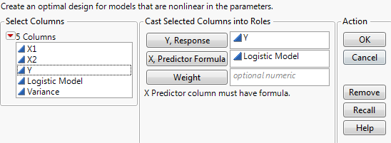

To use the Nonlinear Design platform, you must have an existing data table that contains the following:
A column for the response.
A column for each factor.
A column that contains a formula showing the relationship between the factors and the response. This formula must include the unknown parameters.
For information about formulas, see
Formula Editor
in
The table can contain values for the predictors and response. If it does, the design that you construct augments the design that is implicit in the table. There can be no row containing missing predictor values.
With your starting data table active, select
DOE > Special Purpose > Nonlinear Design
Figure 22.15
Nonlinear Launch Window
Y, Response
The numeric column for response values.
X, Predictor Formula
The numeric column that contains the formula for the nonlinear model. This formula must contain parameters.
Weight
(Optional) A numeric column that assigns weights to the observations.
