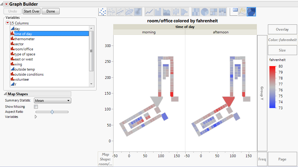

The map shown below is the floor, grouped by time of day. The color reflects the Fahrenheit value. Exploring data visually in this way can give hints as to what factors are affecting office temperature. Looking at this map, it appears the offices on the east side of the building are warmer in the mornings than they are in the afternoons. On the western side of the building, the opposite appears to be true. From this visualization, we might expect that both of these variables are affecting office temperatures, or perhaps that the interaction between these terms is significant. Such visuals help guide decision-making during the analysis.
Figure 14.33 Room/Office Colored by Fahrenheit and Grouped by Time of Day

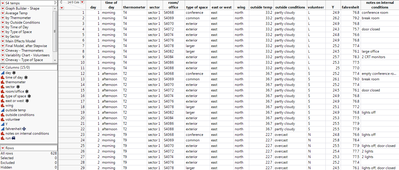

First, data was collected and input into a data table (S4 Temps.jmp). Note the Room/Office column. It contains the unique names for each office and was assigned the Map Role to correctly define the map files.
Figure 14.34 S4 Temps.jmp Data Table

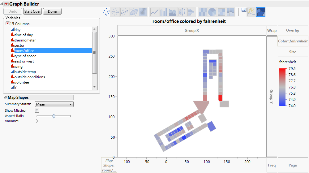

Once the Map Role column property has been set up, you can perform your analysis. You want to visually see the differences in office temperatures throughout the floor.
1.
Select Graph > Graph Builder.
2.
Drag and drop room/office into the Map Shape zone.
Since you have defined the Map Role column property on this column, the map appears.
3.
Drag and drop Fahrenheit to the Color zone.
Figure 14.36 Room/Office Colored by Fahrenheit

Figure 14.37 Room/Office Colored by Fahrenheit and Grouped by Time of Day

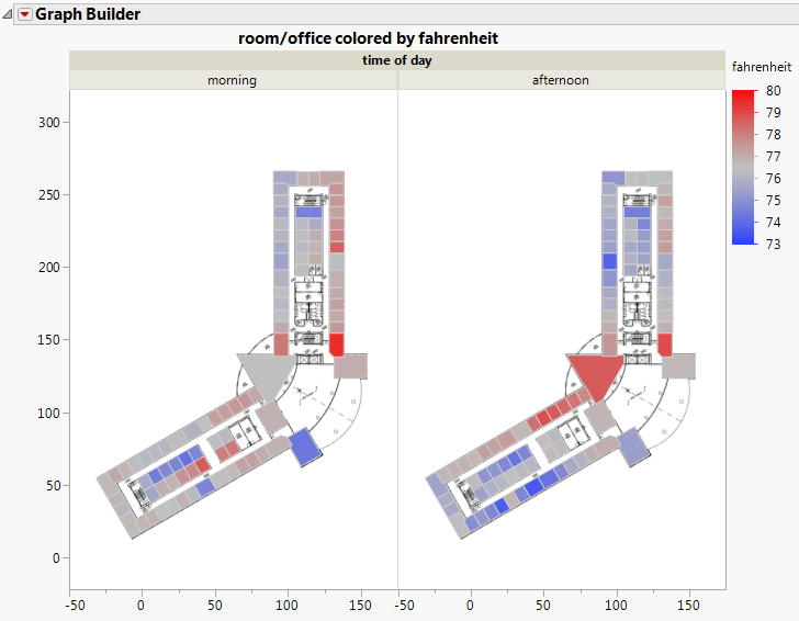

To view Figure 14.38, select Help > Sample Data Library and open S4 Temps.jmp and run the by Time of Day script.
Figure 14.38 Room/Office Map with Original Floor Plan
