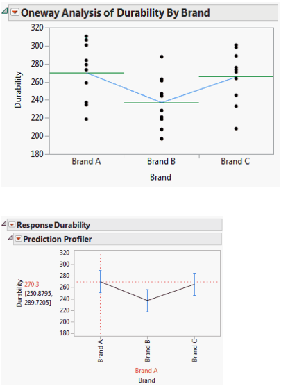

Consider the Golf Balls.jmp sample data table. You are interested in whether Durability varies by Brand. Figure 1.8 shows two plots.
The second plot is a profiler plot obtained using Fit Model. This second plot shows the predicted responses for each brand, connected by line segments. To produce this plot, run the script Fit Model: Durability by Brand in the Golf Balls.jmp sample data table. Drag the vertical dashed red line to the brand of interest. The horizontal dashed red line updates to intersect the vertical axis at the predicted response.
Figure 1.8 Model Fit for One-Way Analysis of Variance
