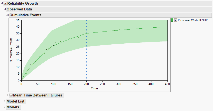

The Cumulative Events plot from the Observed Data report is shown in Figure 9.23. The vertical dashed blue lines indicate the phase transition points. The first occurrence of Revised in the column Design Phase is in row 14. So, the start of the Revised phase is taken to be the Interval Start value in row 14, namely, day 91. Similarly, the first occurrence of Final in the column Design Phase is in row 23. So, the start of the Final phase is taken to be the Interval Start value in row 23, namely, day 200.
Figure 9.23 Cumulative Events Plot

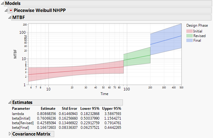

The Piecewise Weibull NHPP report is found under the Models outline node (Figure 9.24). Here we see the mean time between failures increasing over the three phases. From the Estimates report, we see that the estimates of beta decrease over the three testing phases.
Figure 9.24 MTBF Plot
