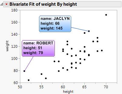

When you place your cursor over data on a graph, a hover label that contains data values appears. You can pin the hover label so it always appears on the graph as a label. When you save the graph, the label is saved. When you print the graph, the label prints.
Note:
The hover label remains pinned after you redo an analysis. However, if the data changed, you might have to reposition the label.
Figure 8.26
Pinned Hover Labels
To pin a hover label, place your cursor over the data point until the label appears. Click the pin icon in the upper right corner of the label. You can then drag the label to reposition it.
