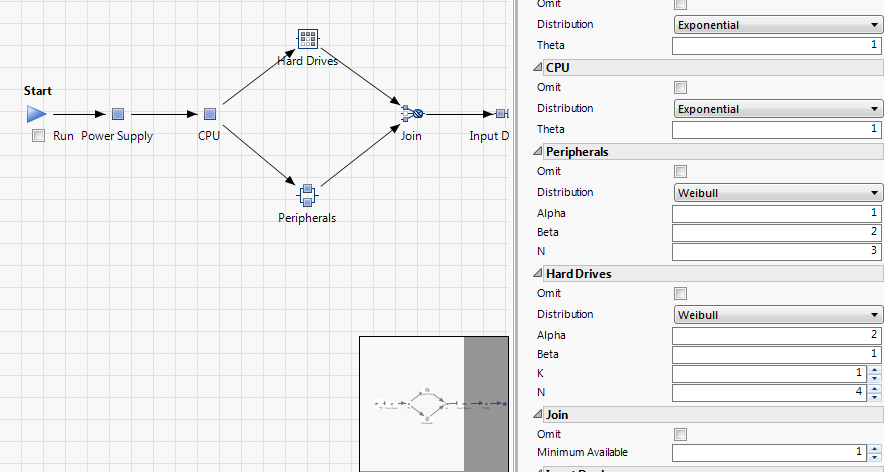

When the system diagram is too large to appear in the workspace, the Preview window enables you to reposition the portion of the system diagram that appears in the workspace. Drag the viewing area, which is indicated in the Preview window by a white background, to reposition the view of the Workspace to another part of the system diagram.
Figure 10.13
Preview Window with Visible Part of Diagram on White Background
