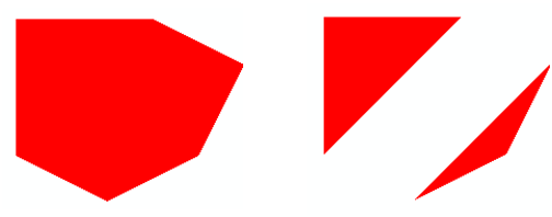

The first section of the script creates a display list named shape. Inside this display list, a polygon is defined using six vertices.
Note that all the z-coordinates are zero, which makes sure the polygon lies in a plane. Polygons that do not lie in a plane can cause unpredictable results.
shape <<Begin(POLYGON);
shape <<Begin(TRIANGLES);
Figure 12.10 Polygon (left) and Triangles (right)
