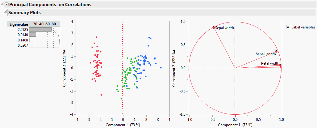

Figure 3.1 Example of Principal Components
