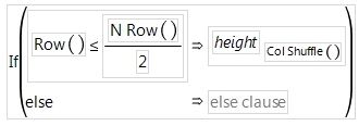

Selects a row number at random from the current data table. Each row number is selected only once. When Col Shuffle is used as a subscript, it returns a value selected at random from the column that serves as its argument. Each value from the original column is assigned only once as Col Shuffle’s result.
Figure A.16 Formula Identifying 50% Random Sample
The formula in Figure A.16 selects half the values (n/2) from the column x and assigns them to the first half of the rows in the computed column. The remaining rows of the computed column fill with missing values.
