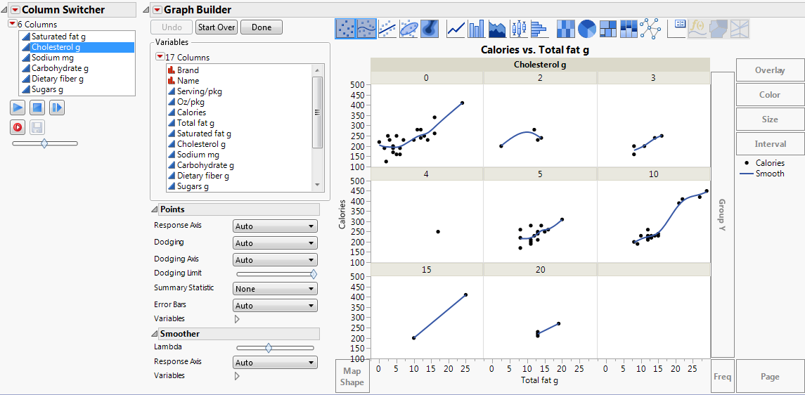

1.
Select Help > Sample Data Library and open Candy Bars.jmp.
2.
Select Graph > Graph Builder.
3.
Click Total fat g and drag to the X zone.
4.
Click Calories and drag to the Y zone.
5.
Click Cholesterol g and drag to the Wrap zone.
7.
Select Cholesterol g and click OK.
8.
Select Saturated fat g, Cholesterol g, Sodium mg, Carbohydrate g, Dietary fiber g, and Sugars g and click OK.
Figure 8.6 Column Switcher in Graph Builder Window
9.
Click the Play button to cycle between the different factors. Use the slider to control the speed of the animation. Alternatively, you can step through each factor individually.
You can see that the relationship between calories and fat is relatively strong for each level of carbohydrate. Therefore, Carbohydrate g appears to be the best predictor of calorie levels.
