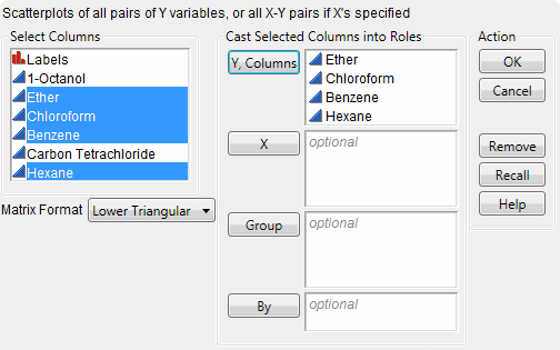

Select Graph > Scatterplot Matrix.
3.
Select Ether, Chloroform, Benzene, and Hexane, and click Y, Columns.
Figure 2.54 Scatterplot Matrix Window

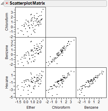

Figure 2.55 Scatterplot Matrix
The data points in the scatterplot for Benzene and Chloroform are the most tightly clustered along an imaginary line.

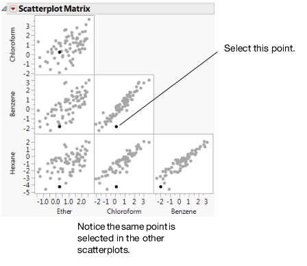

For example, if you select a point in the Benzene versus Chloroform scatterplot, the same point is selected in the other five plots.
Figure 2.56 Selected Points
