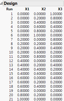

Figure 12.10 Three Factor Five-Level Simplex Lattice Design
5.
Click Make Table.

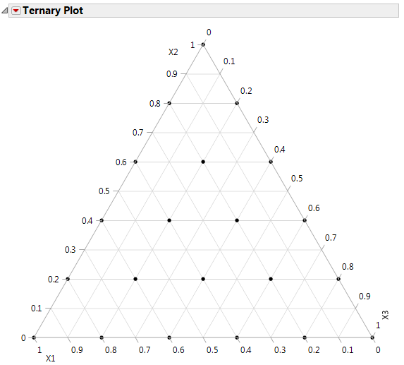

From the design table, select Graph >Ternary Plot.
7.
Select X1, X2, and X3 and click X, Plotting, and then click OK.
Figure 12.11 Ternary Plot for Simplex Lattice Design
