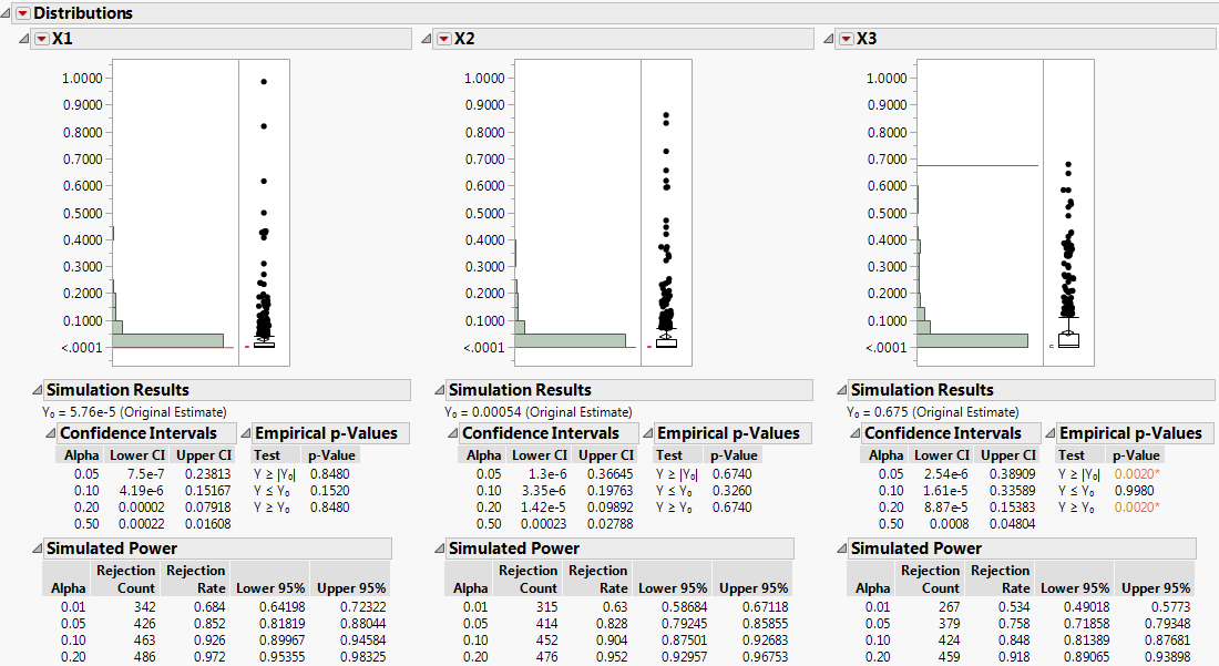

The Simulate option is available in many reports, including all of those that support Bootstrap. To access the Simulate option, right-click in a report.

Power Analysis Using Simulate

Simulated Power Report
