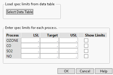

After you click OK on the launch window, the Spec Limits window appears if any of the columns do not contain limits and you did not select No (skip columns with no spec limits) on the launch window. The Spec Limits window also appears if you select Yes on the launch window. Figure 10.7 shows the Spec Limits window for the Cities.jmp sample data table after selecting OZONE, CO, SO2, and NO as process variables in the launch window. Enter the known specification limits and click OK to view the Process Capability report.
Figure 10.7 Spec Limits Window for Cities.jmp
