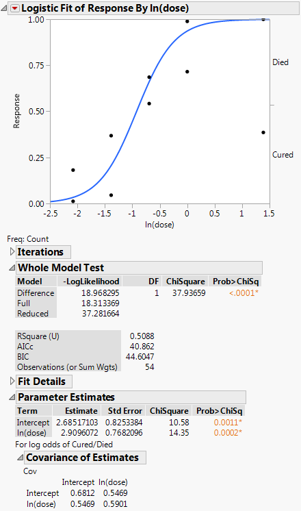

To produce the plot shown in
Figure 7.72
, follow the instructions in
Example of Nominal Logistic Regression
Figure 7.72
Example of a Logistic Report
The Logistic report window contains the Logistic plot, the Iterations report, the Whole Model Test report, the Fit Details report, and the Parameter Estimates report.
