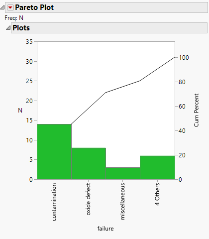

Figure 11.8 Pareto Plot with a Threshold Count of 2
Figure 11.8 displays the plot after specifying a count of 2. All causes with counts 2 or fewer are combined into the final bar labeled 4 Others.

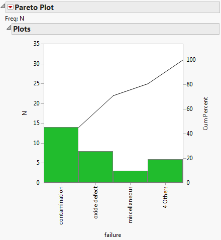

Figure 11.9 Pareto Plot with Separated Causes
