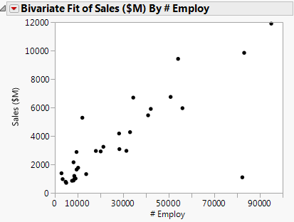

This example uses the Companies.jmp data table, which contains financial data for 32 companies from the pharmaceutical and computer industries.
Figure 3.89 Scatterplot of Sales ($M) versus # Employ

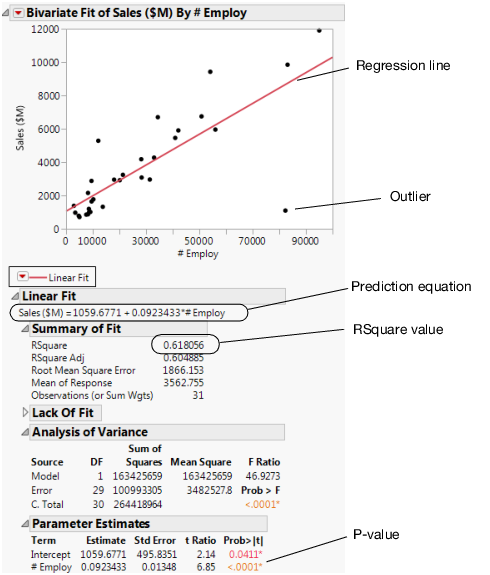

To predict the sales revenue from the number of employees, fit a regression model. From the red triangle for Bivariate Fit, select Fit Line. A regression line is added to the scatterplot and reports are added to the report window.
Figure 3.90 Regression Line

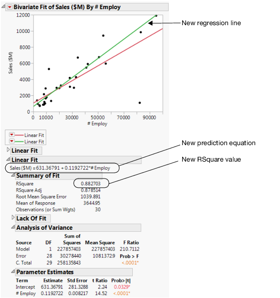

2.
Select Rows > Exclude/Unexclude.
3.
Fit this model by selecting Fit Line from the red triangle menu for Bivariate Fit.
Figure 3.91 Comparing the Models
Using the results in Figure 3.91, the data analyst can make the following conclusions:
