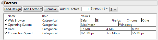

Select Load Factors from the red triangle menu.
Figure A.31 Factors Outline for Software Factors

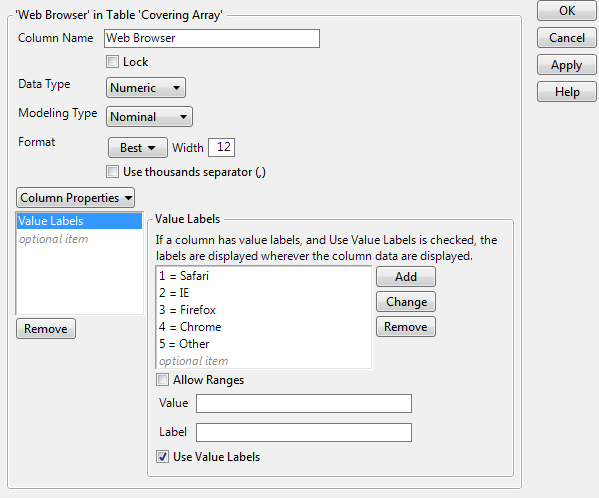

In the columns panel, click the asterisk next to Web Browser and select Value Labels.
Figure A.32 Column Info Window for Factor A
Notice that Web Browser has a Numeric data type and a Nominal modeling type. The underlying values of Web Browser are the integers 1, 2, 3, 4, and 5. These values are assigned value labels corresponding to the values that you entered when you constructed the design.

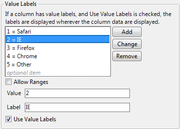

8.
Select 2 = IE in the Value Labels list.
Figure A.33 Value Labels Panel with Selection
9.
Type Internet Explorer next to Label.
10.
Click Change.
