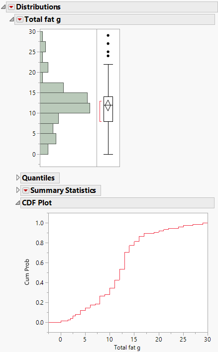

CDF Plot
The CDF plot creates a plot of the empirical cumulative distribution function. Use the CDF plot to determine the percent of data that is at or below a given value on the
x
-axis.
Figure 3.10
CDF Plot
For example, in this CDF plot, approximately 34% of the data is less than a total fat value of 10 grams.
