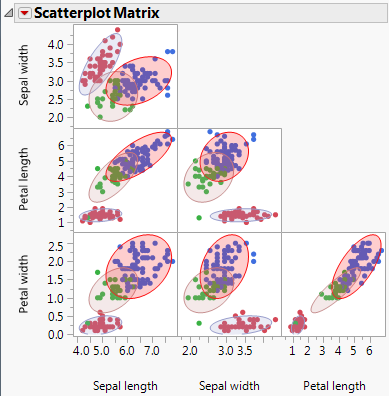

You can see that a Cluster column has been added to the Iris.jmp data table.
Figure 12.9 Example of a Scatterplot Matrix Using a Cluster Variable
