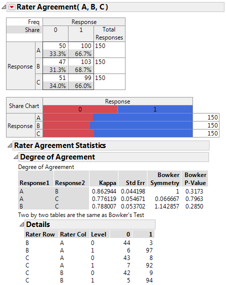

This example uses the Attribute Gauge.jmp sample data, which has the ratings (0/1) from three operators rating 50 parts 3 times.
1.
Select Help > Sample Data Library and open Attribute Gauge.jmp.
2.
Select Analyze > Consumer Research > Categorical.
3.
Select A, B, and C.
4.
5.
Figure 3.16 Rater Agreement Report
