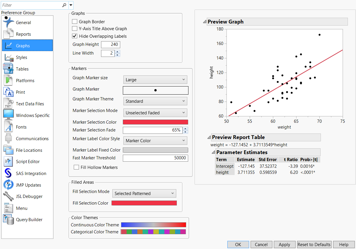

Graph preferences customize the appearance of graphs. See
Styles
for additional details about configuring the appearance of graphs.
Figure 13.3
Graphs Preferences
Table 13.3
Preferences on the Graphs Page
Preference
Description
Graph Border
Draws a border line around the area of the graph. This option is not selected by default.
Y-Axis Title Above Graph
Shows the Title for the Y-Axis above the line rather than beside the line. This option is not selected by default.
Hide Overlapping Labels
Select this option to hide overlapping chart labels. This option is selected by default.
Graph Height
Sets the default height (in pixels) for a graph. Default is 240 pixels. Some platforms take the value and multiply it by a certain amount.
Note:
With Graph Builder windows, specifying the Graph Height enlarges the window proportionally, but the exact value is not applied.
Line Width
Sets the default width (in pixels) for lines that pertain to content. Default is 2 pixels.
Note:
Does not apply to grid lines.
Graph Marker Size
Select a default size for the markers in graphs: Dot, Small, Medium, Large, XL, XXL, or XXXL. This preference is applied when the marker size is set to Preferred on a graph.
If the Marker Threshold is Fast, the Dot marker size is applied.
Graph Marker
Select a default marker shape for the markers in graphs.
Graph Marker Theme
Select a default theme for the markers in graphs when you mark by row or column.
Marker Selection Mode
Select the default formatting for selected markers. See
Marker Selection Modes
in JMP Reports
Marker Selection Color
When the Marker Selection Mode is Selected Same Color, this setting applies the specified color to selected markers. Default color is Red.
Marker Selection Fade
When the Marker Selection Mode is Unselected Faded, this setting fades the unselected markers by the specified amount (in percent). The default is 65%.
Marker Label Color Style
Select the color of the marker label that appears on a graph when you label a column in the data table.
Marker Color
The marker label is the same color as the marker. This option is selected by default.
Marker Color Faded
The marker label is faded according to the Marker Selection Fade preference.
Fixed Color
The marker label color is as specified. The Marker Label Fixed Color preference determines the color.
Select the color of fixed-color marker labels, an option that you select in the Marker Label Color Style preference. The default color is gray.
Fast Marker Threshold
When JMP refreshes a report window, it can draw markers or points on a plot at two different speeds: normal and fast. If JMP is in normal drawing mode, and the number of markers on a graph are more than the specified threshold number, JMP automatically switches to fast mode.
Enter the number of markers that separate normal and fast mode. The default is 50,000. The Dot marker size is applied for the Fast Marker Threshold.
Fill Hollow Markers
Select this option to apply an opaque background to markers.
Fill Selection Mode
Select the default highlight for selected rows in graphic objects:
Selected Patterned
A striped pattern (default)
Selected Darkened
A solid darker color
Selected Outlined
An outline
Selected Same Color
The Fill Selection Color in the preferences formats the selected object.
Select the default color of selected rows in graphic objects when the Fill Selection Mode is “Selected Same Color”. The default color is red.
Continuous Color Theme
Select a default color theme for continuous data. The default theme is Blue to Gray to Red. See
Create Color Themes
in Enter and Edit Data
Categorical Color Theme
Select a default color theme for categorical data. The default theme is JMP Default. See
Create Color Themes
