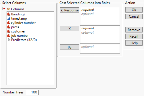

Launch the Predictor Screening platform by selecting
Analyze > Screening > Predictor Screening
Figure 20.3
Predictor Screening Launch Window
Y, Response
The response columns.
X
Predictor columns.
By
A column or columns whose levels define separate analyses. For each level of the specified column, the corresponding rows are analyzed using the other variables that you have specified. The results are presented in separate reports. If more than one By variable is assigned, a separate report is produced for each possible combination of the levels of the By variables.
Number of Trees
The number of decision trees in the bootstrap forest model.
