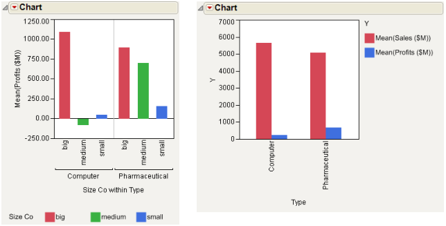

Legends are shown as needed. If your chart uses different colors or markers to show levels of one or two X variables, a legend below the chart shows them. If your chart uses different colors or markers to show more than one statistic, a legend to the right of the chart shows them.
Figure 14.7
Examples of an X Legend (left) and Y Legend (right)
