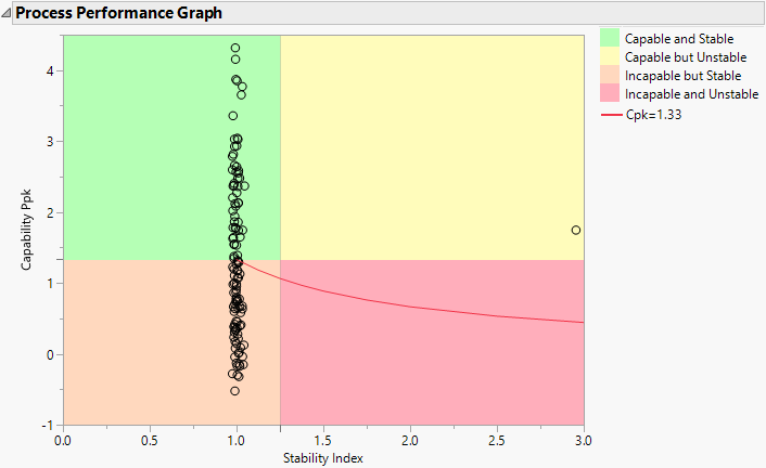

Use the Process Screening platform for exploring a large number of processes across time. The platform calculates process stability and process capability metrics. The platform creates control charts and detects large process shifts. The platform is intended to expedite the evaluation of a very large number of processes by enabling you to quickly focus on the processes that are unstable, not capable of meeting specification limits, or subject to shifts in the mean.
Based on your initial results, you can choose to explore specific processes graphically or in greater analytical depth. You can easily access the Control Chart Builder and Process Capability platforms. You can save detailed results for all of your processes or for specific processes.
Figure 19.1
Example of a Process Performance Graph
