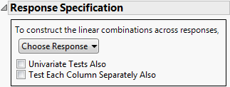

Response Specification
Specify the response designs for various tests using the Response Specification panel.
Figure 9.3
Response Specification Panel
Choose Response
Provides choices for the M matrix. See
Choose Response Options
Univariate Tests Also
Obtains adjusted and unadjusted univariate repeated measures tests and multivariate tests. Use in repeated measures models.
Test Each Column Separately Also
Obtains univariate ANOVA tests and multivariate tests on each response.
The following buttons are available only after you have chosen a response option:
Run
Performs the analysis and shows the multivariate estimates and tests. See
Multivariate Tests
Help
Shows the Help for the Response Specification panel.
Orthogonalize
Orthonormalizes the matrix. Orthonormalization is done after the column contrasts (sum to zero) for all response types except Sum.
Delete Last Column
Reduces the dimensionality of the transformation.
