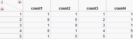

Creates a list of values beginning with the from value and ending with the to value. The number of steps specifies the number of values in the list between and including the from and to values. Each value determined by the first three arguments of the count function occurs consecutively the number of times that you specify with the times argument. When the to value is reached, Count starts over at the from value.
Also, you can add the times argument with the insert button
on the keyboard. This argument is one by default, but repeats the count process as many times as you specify, as illustrated by the Count4 column in the data table in Figure A.2. To add any argument to the Count function, highlight the argument preceding the one that you want to enter. Either type a comma or use the insert button
on the Formula Editor keypad.
Count (1, 9, 2) gives Count 1
Count (1, 9, 3) gives Count 2
Count (1, 9, 9) gives Count 3
Count (1, 9, 3, 3) gives Count 4
