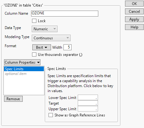

When you perform a capability analysis, you can use Column Properties > Spec Limits to save specification limits as a column property. The Spec Limits property applies only to numeric columns.
Some processes have one-sided specifications. Some have no target. You can enter any of these that apply: a lower specification limit, an upper specification limit, or a target value.
Figure 11.10
displays the Spec Limits section of the Column Properties window for
OZONE
in the sample data table
Cities.jmp
Figure 11.10
Spec Limits Section of the Column Properties Window
