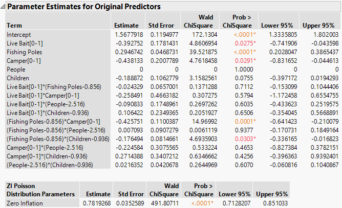

From the Personality list, select Generalized Regression.
8.
Click Run.
10.
Figure 7.6 Parameter Estimates for Original Predictors Report
The Effect Tests report indicates that five terms are significant at the 0.05 level: Live Bait, Fishing Poles, Camper, Fishing Poles*Camper, and Fishing Poles*Children.

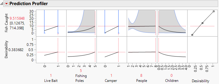

12.
Click the Prediction Profiler red triangle menu and select Optimization and Desirability > Desirability Functions.
A function is imposed on the response, which indicates that maximizing the number of Fish Caught is desirable. (See Desirability Profiling and Optimization the Profilers book for more information about desirability functions.)
13.
Click the Prediction Profiler red triangle menu and select Optimization and Desirability > Maximize Desirability.
Figure 7.7 Prediction Profiler with Fish Caught Maximized
You can vary the settings of the predictors to see the impact of the significant effects: Live Bait, Fishing Poles, Fishing Poles*Camper, and Fishing Poles*Children. For example, Live Bait is associated with more fish; a Camper tends to bring more fishing poles than someone who is not camping and therefore catches more fish.
