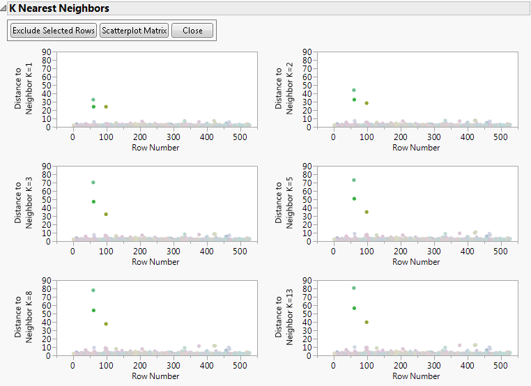

Figure 20.9 Outliers in Multivariate k-Nearest Neighbor Outliers Example
Notice the three extreme outliers selected in the K Nearest Neighbors plots. Each of these three rows corresponds to a date when the secondary settler in the water treatment plant was reported as malfunctioning. Because these three data points are due to faulty equipment, exclude them from future analyses.
8. Select the three extreme outliers and click Exclude Selected Rows.

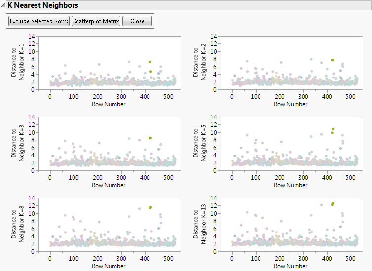

Figure 20.10 Outliers in Multivariate k-Nearest Neighbors Example
Now locate the two light-green outliers close to row 400. Notice how they tend to stay close to each other as k increases. These two rows correspond to dates when solids overloads were experienced by the water treatment plant. Even though these data points have a relatively high Distance to Neighbor K=13, you do not exclude them. This is because they are due to a situation that you want to include in your study. Instead, you keep them in mind as you conduct further analyses.
