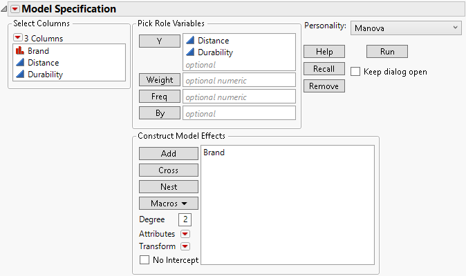

1. Select Help > Sample Data Library and open Golf Balls.jmp.
3. Select Distance and Durability and click Y.
4. Select Brand and click Add.
5. For Personality, select Manova.
Figure 9.1 Manova Setup
6. Click Run.

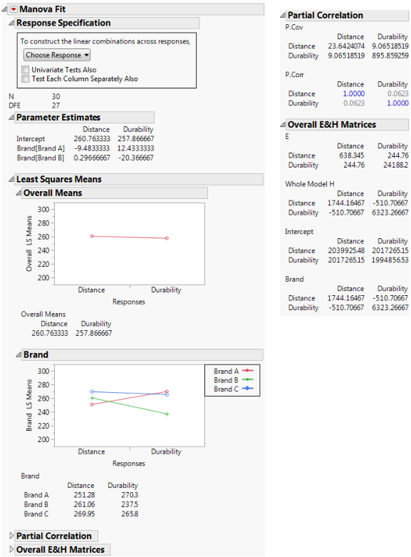

Figure 9.2 Manova Report Window
The initial results might not be very interesting in themselves, because no response design has been specified yet. After you specify a response design, the multivariate platform displays tables of multivariate estimates and tests. For more information about specifying a response design, see Response Specification.
