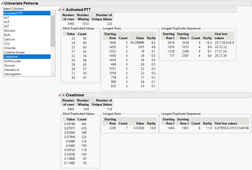

6. In the Univariate Patterns report, the report for the first column, Activated PTT, is shown initially. Hold down the Ctrl key and select Creatinine from the Select Columns list.
Figure 20.16 Explore Patterns Univariate Patterns ReportĀ
As you select column names from the Select Columns list, the corresponding column reports are shown. The Activated PTT report shows that this column contains several three count runs and four count sequences. The Creatinine report shows that although it is the column with the highest rarity score for Longest Runs, there is only one run in the column. This column also has one eight count sequence.
