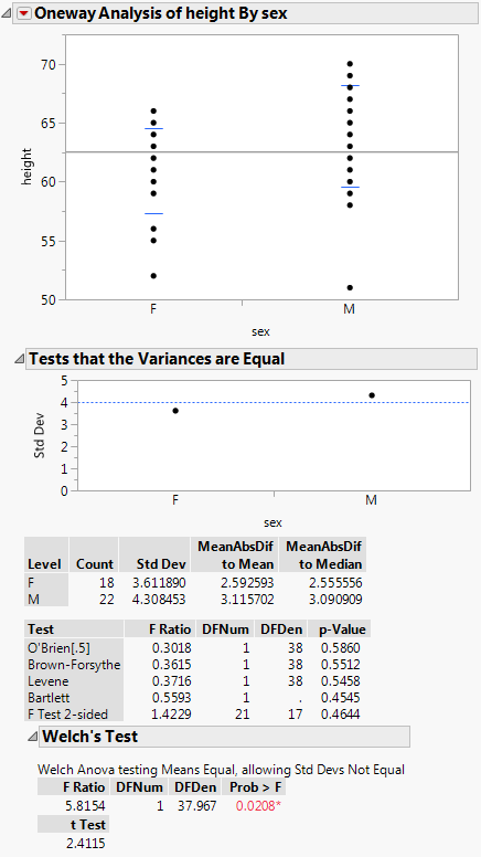

Suppose you want to test whether two variances (males and females) are equal, instead of two means.
3. Select height and click Y, Response.
4. Select sex and click X, Factor.
5. Click OK.
6. Click the red triangle next to Oneway Analysis of height By sex and select Unequal Variances.
Figure 6.29 Example of the Unequal Variances ReportĀ
Since the p-value from the 2-sided F Test is large, you cannot conclude that the variances are unequal.
