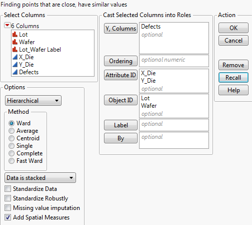

1. Select Help > Sample Data Library and open Wafer Stacked.jmp.
2. Select Analyze > Clustering > Hierarchical Cluster.
3. In the list in the lower left corner, change Data as usual to Data is stacked.
Additional options for stacked data appear in the launch window.
4. Select Defects and click Y, Columns.
5. Select X_Die and Y_Die and click Attribute ID.
6. Select Lot and Wafer and click Object ID.
7. Select Add Spatial Measures from the list of options in the lower left corner.
Figure 12.8 Completed Clustering Launch Window
8. Click OK.

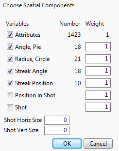

Figure 12.9 Spatial Components Window
Because Defects is measured at 1423 locations, there are 1423 Attributes variables.
9. Click OK to accept the selections in the Spatial window.

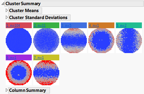

13. Click the Hierarchical Clustering red triangle and select Cluster Summary.
Figure 12.10 Cluster Summary Report
The wafer maps indicate the spatial nature of defects for each cluster. Cluster 1 contains 104 wafers with relatively few defects that are spread throughout the wafers. Cluster 3 has 5 wafers with defects concentrated at the extremes of the top and bottom hemispheres. You can view the maps for individual wafers and their Hough space maps in the data table produced by the cluster analysis. See Spatial Measures.
