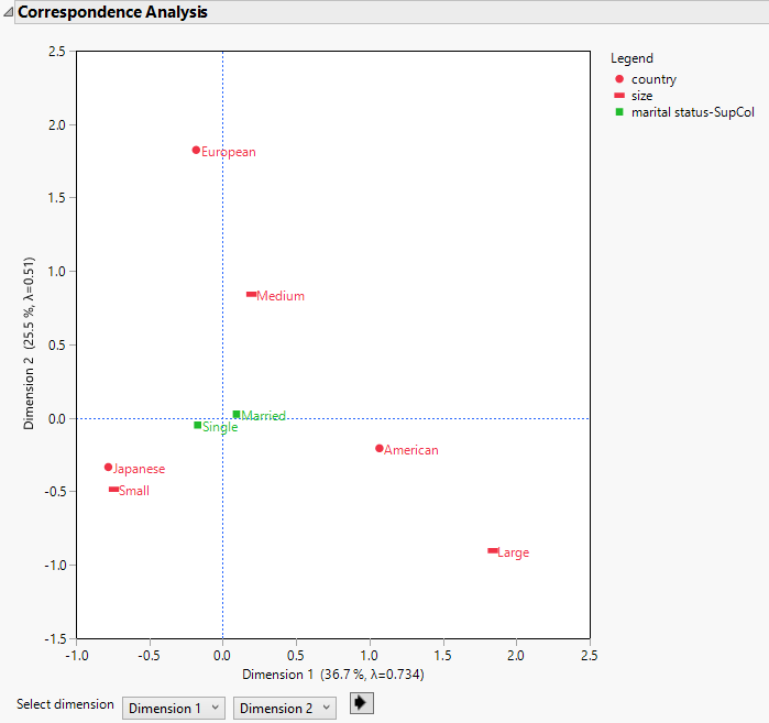

Unlike in the first example, this analysis does not use marital status in the calculations. Marital status is plotted after the calculations are complete.
You see from the plot strong relationships between Japanese and Small cars as well as American and Large cars. The two marital statuses are plotted in a different color. Single people seem to prefer smaller cars a bit more than married people.
Figure 7.6 MCA with Supplementary Variable ReportĀ
